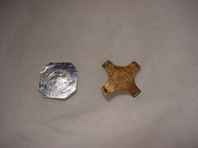

Thanks Paul, It's always good to have some feedback. It "is" an interesting subject. What shape was that reed that the Australian modeler had?
Here's an odd reed that I removed from an engine many years ago. It's approx. .004" thick.. and looks like it may be Stainless Steel. It's in pretty bad shape.. and I can't remember ever running it.
