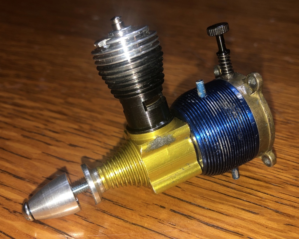

sosam117, glad to hear you're not going to push for a recount It was a close one!
Yep, Jason_WI and his "Pieces and parts RR-1. New crank, rotary valve, and drive plate. Early #1 cylinder. Drilled out golden bee backplate. Battle hardened crankcase and tank."
I'll get the picture up shortly!

Jason_WI --- RR-1 and sosam117 --- RR-1
I was going to post my repair/rebuild of my RR-1.
But Jason beat me, and posted his RR-1 first. (should I post mine next month?)
I did almost the same thing as Jason_WI for the back plate.
My back plate had two mounting hole broken off.
Took a metal back plate from a Baby Bee, drill the hole out then reamed the hole
with a long taper reamer to get a good tight fit so it would not leak like Jason's does.
Hand taper reamer set: good for soft metals, like aluminum, brass, copper, and plastics.
Here is my rebuilt RR-1:
Jason_WI rebuilt RR-1

Jason, Congratulations, very good engine and a photo with very good details.
Enjoy the moment friend!

Congratulations Jason !! Good clean fight to the wire
