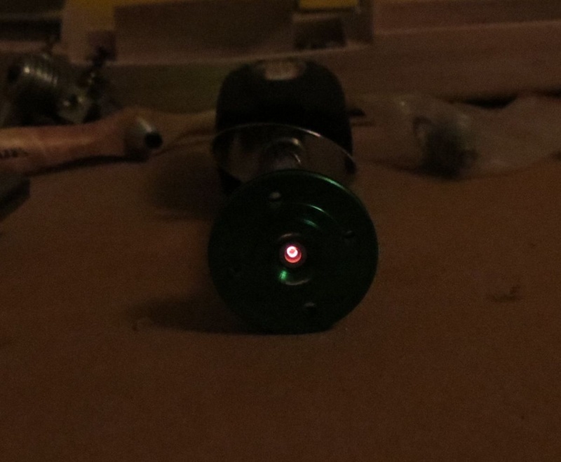

Post  Surfer_kris Sat Mar 08, 2014 12:25 pm
I have posted this earlier somewhere on this forum, but I can't remember where...
I did a little comparison between a regular NiMh driver and a Lipo driver. First photo shows the two drivers, second is the NiMh one and the last one is the Lipo driver (both taken with the same exposure time during operation;
Glow plug igniter. Img_1323
Glow plug igniter. Img_1324
Glow plug igniter. Img_1325
